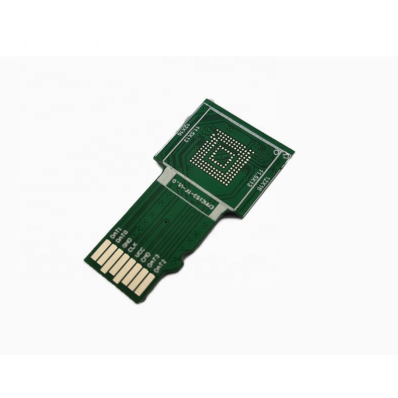

Hello, excuse in advance my English which is not my native language.
I am electronicien, so i am a Noob on Linux, i prefer the hardware.
I'm working on a "NanoPI NEO" and I would like to use an EMMC with an sd slot I drew. Because i kill 3 sd card last years.
So i do it, like this
i use the chip thgbmjg6c1lbail which is an emmc v5.1 8gO.
https://jlcpcb.com/partdetail/Kioxia-THGBMJG6C1LBAIL/C524518
This card works very well on my computer with ubuntu, or my RPI4 with raspbian, but impossible to use it with armbian as well on my nanopi neo or my nanopi M1.

Begin: Will now check root file system ... fsck from util-linux 2.36.1
[/sbin/fsck.ext4 (1) -- /dev/mmcblk0p1] fsck.ext4 -a -C0 /dev/mmcblk0p1
armbian_root: recovering journal
[    8.470442] sunxi-mmc 1c0f000.mmc: data error, sending stop command
[    9.423453] sched: RT throttling activated
[    9.475465] sunxi-mmc 1c0f000.mmc: send stop command failed
[   37.879518] vcc3v0: disabling
[   37.882552] vcc5v0: disabling
 and it's stop
I know I did a novel. A big thank you in advance for your help, I've been obsessed with this problem for a month.
Thanks a lot
Best regard
  • Author
and just for information
with U-Boot i can read and write inside the emmc
=> mmc write 0 0 100
MMC write: dev # 0, block # 0, count 256 ... 256 blocks written: OK
=> mmc read 0 0 100
MMC read: dev # 0, block # 0, count 256 ... 256 blocks read: OK
so i don't understand what's happen, the driver inside the Kernel?
Best Regards
  • Author
Hello if it can help
I read somethings on other site
but i don't know how i can do it
https://www.spinics.net/lists/linux-omap/msg162064.html
who talk about "mmc: core: adjust polling interval for CMD1 "
or blocking the clock so as not to rise above 50MHz as the RPI with raspbian
or " Specifics of using a processor which stops the clock after CMD0"
https://community.silabs.com/s/article/linux-sdio-detection?language=en_US
but this is beyond my skills
if a linuxian in the corner who knows how can i modify de driver and recompile the kernel
22879692e72fefd5137f1bbcf3be7f73790de594
best regards
Edited by Kazymir
