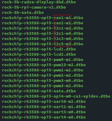

Then you need to find the names of overlays, you can get them by running the following in your terminal:
ls -l /boot/dtb/rockchip/overlay
Scroll down and you will see:
So if you want CAN bus and i2c then your Bootenv overlays should look like this:
overlay_prefix=rockchip-rk3588-opi5
overlays=can1-m1 can2-m1 i2c1-m2 i2c1-m4 i2c3-m0 i2c5-m3
Restart your OPi5 for changes to take effect.

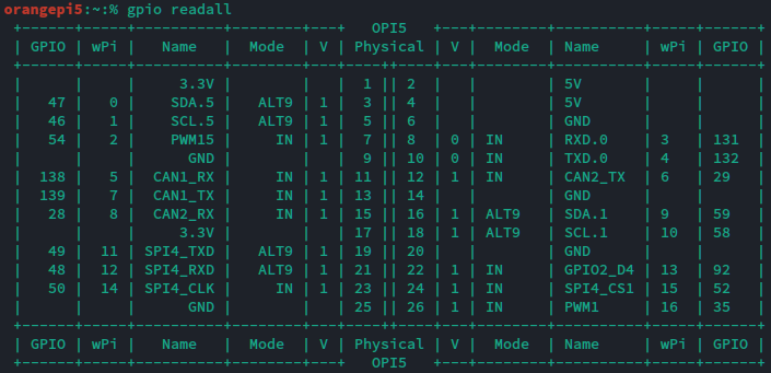

ReadME doesn't have "gpio read all" for OPi5 so here you go:
I have not personally tried CAN bus but it should work, I have tested i2c-1 and it works properly.
