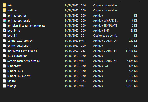

renamed the file 'u-boot-s905x-s912' a 'u-boot.ext'.
The extlinux.conf file contains:

In briefly reviewing the install instructions you followed I didn't find anything significantly different than the instructions in the FAQ.  (Other than I recommend that you copy, not rename the uboot file, so you still have the original around).

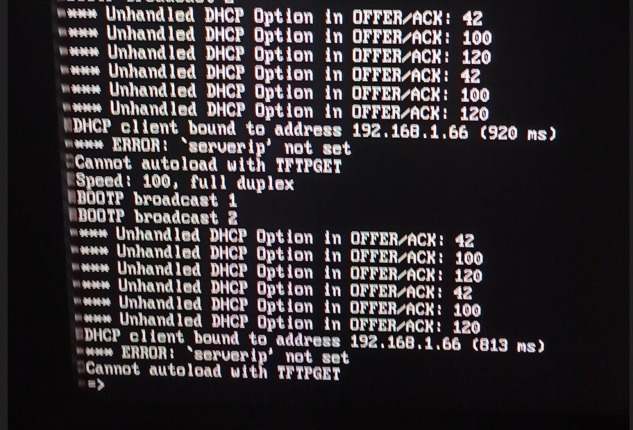

Given the screen shots, it looks like you are booting into the uboot file from your sd card as you are getting hdmi output.  What I would really want to see is the first part of the boot displayed on the screen, not the end part you have shown.
Also, the extlinux.conf file you have pasted into your post isn't quite correct, but I think it may be a result of cut and paste and not a real problem.  It would be helpful if you could attach the actual extlinux.conf file as a file instead of pasting it into the message.  The part that is suspicious is that: "#aml s9xxx #FDT" is all on one line.  The "#FDT" should be on the next line.
