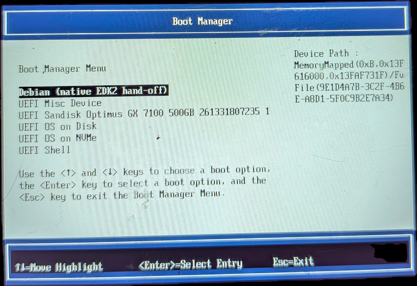

@eselarm
holy smokes I didn't even catch it, thanks!
Opus 5 Reply: "
Definitive — the reviewer is right, and it's a real bug rather than a typo. MIDR straight off the silicon:
cpu0-cpu5  part=0xd05  Cortex-A55   max 1794 MHz
cpu6-cpu7  part=0xd0b  Cortex-A76   max 2002 MHz
2× Cortex-A76 + 6× Cortex-A55. Our README says it correctly in one place (line 352) and incorrectly in another (line 120), and — worse — SunxiSmbiosDxe reports 4x A76 + 4x A55 in the SMBIOS Type 4 table, so every OS that boots this firmware is being told the wrong CPU topology. That's not a doc nit; it's wrong data on the wire.
Let me see the surrounding context before fixing."

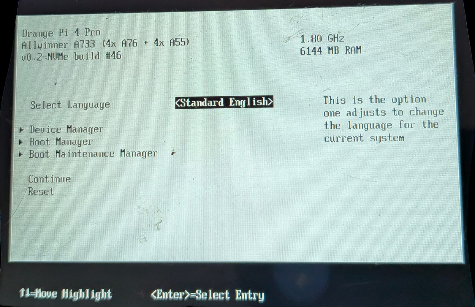

I have seen the Orange Pi 4 Pro being mentioned. Is it similar enough to the Radxa A7* to use the same DTS? Is the Oranpe Pi Zero 3w also similar enough? (it has the same form factor as the Radxa A7z and same A733).
Jacob, you should understand everything that Claude produces for you. Keep track of what it's changing in the EDK code.
Make a diff patch from the unchanged code, and the code you are compiling. All the differences need to be sanity-checked by regular users, and rationalized by experts.
And share a link to the starting original EDK.
